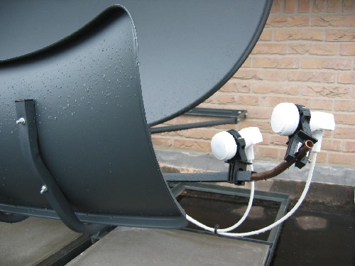

Gast Geplaatst: 12 december 2005 Geplaatst: 12 december 2005 Hi Guys, Sorry to ask this in english but it seems your site is the only one talking about Wavefrontier installations. My problem (which is not really one) is that I would like to recieve Astra 19.2E and Hispasat 30W on my T90. Obviously the rail is 46°+ degrees long and I read on this board that some of you have used an extra clamp to get those sat. My question is which clamps have you used and how did you do it ? Thanks, Fabrice
Tomd Geplaatst: 12 december 2005 Geplaatst: 12 december 2005 Hi fabrice1973 herwith I put als BIJLAGE on top of this screen some Image's of my Wavefrontier, and how I put this "Clamp" on the Wave...... SUC6 <img src="/forums/images/graemlins/xyxthumbs.gif" alt="" /> DM 7000S, Open PLi®, West Dig 160GB HD,1 USB 160Mb, CD Abo, Maxplus 2100+ TechniSat Multytenne 45cm 28.2E --> 13.0E
Tomd Geplaatst: 12 december 2005 Geplaatst: 12 december 2005 Hierbij DM 7000S, Open PLi®, West Dig 160GB HD,1 USB 160Mb, CD Abo, Maxplus 2100+ TechniSat Multytenne 45cm 28.2E --> 13.0E
Gast Geplaatst: 13 december 2005 Geplaatst: 13 december 2005 Dank U wel Tomd ! Sounds easy to do and have read on the other topic the quality of signal was decent. I've seen this on a German site but the price is nearly the Wavefrontier one nowadays. Olbort Except if someone knows a place where I can buy this for half price, I'll do the same as you and Alan S.
