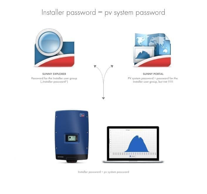

Onderstaande tekst al tegengekomen op de SMA site
It gets more complicated if the default password was not changed during start-up. For security reasons, you cannot simply enter the standard password 1111 into Sunny Portal. What happens if you do? The new password overwrites the default password and applies it to all devices registered in the Sunny Portal system. Please keep this in mind, and be sure to write down the pv system password you set up in Sunny Portal.
If you later try to access your devices on-site (for example with Sunny Explorer) using the default password for the “Installer” user group, it will no longer work. Please use the password that you created as the pv system password in Sunny Portal.
Please do remember that the password for the "Installer" user group and the system password is one and the same password. In this way, you can access all devices in the plant through both, Sunny Explorer and Sunny Portal. All data are displayed.
Please do remember that the password for the “Installer” user group and the system password is one and the same password. In this way, you can access all devices in the plant through both, Sunny Explorer and Sunny Portal. All data are displayed.
