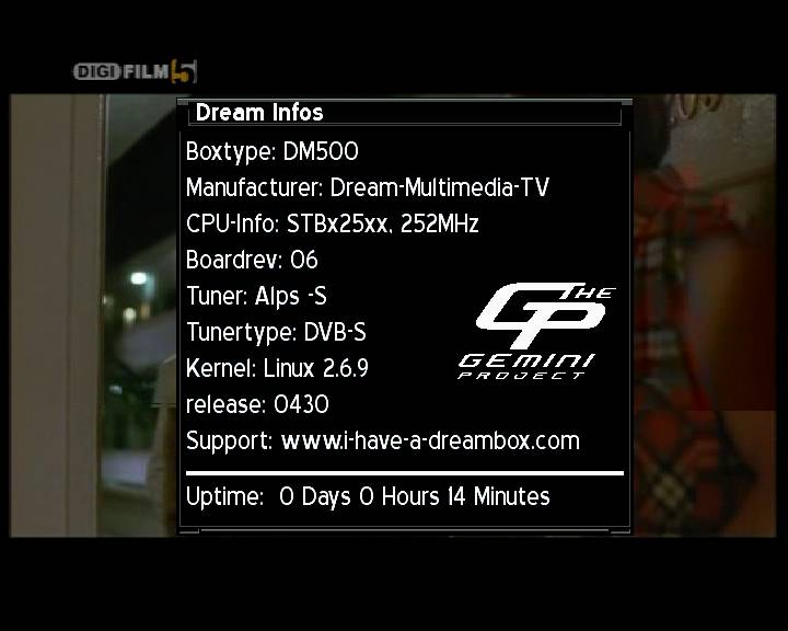

rigave Geplaatst: 24 februari 2008 Geplaatst: 24 februari 2008 He jongens, Heb gemini 4.30 op mijn db 500 gezet. Bleupanel is gelukkig niet gelocked, maar ik kan geen cams dl. Ik kan nu in tegenstelling tot de 4.10 "gemini server" of "my own server" dl. Bij beide krijg ik host etc. not found. Doe ik wat verkeerd of is de server down?
Hulkie Geplaatst: 24 februari 2008 Geplaatst: 24 februari 2008 Had ik ook met Gemini 4.20. Na een herstart (stroom eraf) deed ie het. Misschien ook bij jou??

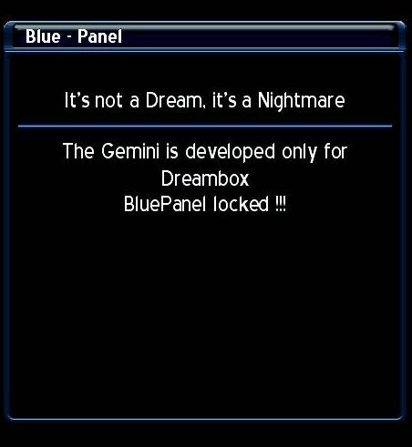

Radix Geplaatst: 25 februari 2008 Geplaatst: 25 februari 2008 Is er een actie tegen Dreambox clones en daardoor is de bluepanel gelocked, zie info hieronder: Citaat: With the release of the GP 4.3, we have added a feature to the Blue panel to detect fake Dreambox clones. We want to show our protest against clones and replicas of Dreamboxes. It cannot be in our interest, to allow the fake boxes to hard the big dreambox community and in fact our beloved hobby. Like some of you should know, some weeks ago a new box came to the market. It’s sold as a completely new development. But if you check that box exactly, you will soon find out that not only the same images, software and drivers were used, but also the nearly identical hardware, such as for example in the Dreambox DM500. According to some owners of this new box, it is being shipped and sold with a preinstalled Gemini Image, which is not in our interest. Even in the manufacturers forum, Gemini images where posted with a warning “runs only on Box XYZ”. We as a Dreambox board and Developer of the Gemini Images can’t tolerate this trend. It is not in our interest that our know-how, our knowledge of the Dreamboxes, and our time is used by a third party manufactorer to sell his copies with our software In fact, the truth is that these manufactorers are themselves not able to provide a self developed image for their receivers. The Blue Panel server is operated, managed and financed by private funds. Also the support we offer for the Gemini images and the genuine Dreamboxes is exploited by the fake clone developers and owners. We can not prevent these people from using the Gemini images, but what we can do is making it as hard as possible for these people to gain money with our work. Therefore, we implemented in the images that are also running on the boxes described above a lock for the BluePanel server. The detection mechanism, whether it is a replica or a Dreambox, has been activated in the current DM500 release. Other Box types will follow. If a box is identified as a non-genuine clone of a Dreambox, the access to the BluePanel is locked. Since this method of detection is still very new, it could unfortunately occur that even genuine boxes are identified as fakes and as a consequence the BluePanel would be locked also on original Dreamboxes. In the meantime, there are some known problems where repaired boxes can’t by recognized as genuine due to the replaced hardware parts. We will do everything the reduce the number of false identifications but nevertheless we cannot decrease the error rate to zero, as the necessary data from DMM is not available. If your Box is falsely identified as a fake box, please understand that we do this in order to maintain the Dreambox community. We ask all users of our images to do everything possible to ensure that our hobby can live on and we will fight together against such unfair methods. We as developers want our Gemini images only to run on Dreamboxes... The IHAD/Gemini Team Dreambox 8000 HD- 1TB HD - OpenPli Image

Gast BRUUT-DREAM Geplaatst: 25 februari 2008 Geplaatst: 25 februari 2008 Origineel bericht van: Radix Is er een actie tegen Dreambox clones en daardoor is de bluepanel gelocked, zie info hieronder: Daar is al een fix voor

Frans B Geplaatst: 25 februari 2008 Geplaatst: 25 februari 2008 Dat is wel logisch. Tijdens het booten worden er zeker veel data in het geheugen gezet. Als je dan aan het mac adres gaat rommelen, blijft dat in het geheugen staan, vandaar die reset. Ik ben weer lekker terug gegaan naar 4.20, ik zag geen enkele meerwaarde van de 4.30 versie. gepensioneerd. En 25 jaar lid van sat4all.
Gast Tahir Geplaatst: 5 maart 2008 Geplaatst: 5 maart 2008 Hallo Allemaal, het enige wat ze doen is de MAC adres reeks van Dream multimedia controleren... zit je MAC adres daar niet tussen dan kun je blue panel niet gebruiken .. als je ontvanger laat repareren.... komt niuwe netwerk chip erin met nieuwe MAC adres dan hang je ook want dan is je orginele box ineens een clone geworden. Dream multimedia levert hiermee via Gemini het bewijs dat ze al die tijd zelf achter deze software zaten..waarmee heel veel mogelijk is wat allemaal niet mag. IMMERS HOE WEET MEN BIJ GEMINI,DE MAC ADRESSEN DIE DREAM MULTIMEDIA HEEFT UITGEGEVEN.?????!!!!! Oplossing; je MAC adres veranderen... die moet beginnen met 00:09:34:xx:xx:xx XX moet je vervangen door willekeurige getal. zo kun je het ook doen.. gebruik DCC telnet naar je ontvanger .. (dit heb ik ook van de net ) cd /var/etc rm init echo \#!/bin/sh >> init echo ifconfig eth0 down >> init echo ifconfig eth0 hw ether 00:09:34:xx:xx:xx >> init echo ifconfig eth0 up >> init chmod 755 init reboot dan is je clone weer een orgineel dreambox..........hahaha
rai Geplaatst: 5 maart 2008 Geplaatst: 5 maart 2008 Er is inmiddesl een 4.31 versie waar die check is uitgesloopt. Zie de IHAD site met uitleg.
