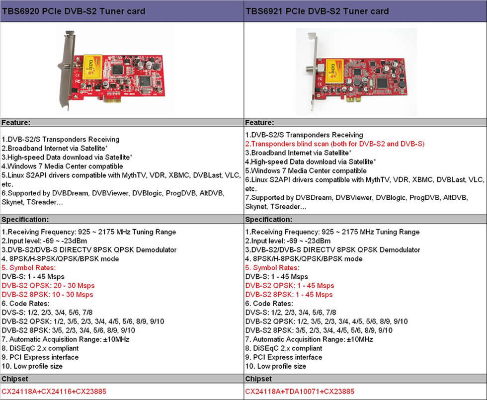

Crazy Sat Geplaatst: 26 januari 2011 Geplaatst: 26 januari 2011 Heb reeds wat fraais gelezen voor deze kaart : Weten jullie hier meer over ? TBS 6921 PCI-E DVB-S2 TV Tuner Card Specifications : Main Features: * 1.DVB-S2/S Transponders Receiving 2.Transponders blind scan 3.Broadband Internet via Satellite* 4.High-speed Data download via Satellite* 5. Linux MythTV, VDR, XBMC and Windows 7 Media Center compatible 6.Supported by DVBDream, DVBViewer, DVBlogic, ProgDVB, Skynet, TSreader… Specifications: * 1.Receiving Frequency: 925~2175 MHz Tuning Range 2.Input level: -69~ -23dBm 3.DVB-S2/DVB-S DIRECTV 8PSK QPSK Demodulator 4. 8PSK/H-8PSK/QPSK/BPSK mode 5. Symbol Rates: DVB-S2 QPSK/8PSK and DVB-S:1-45 Msps 6. Code Rates: DVB-S2 QPSK: 1/2,3/5,2/3,3/4,4/5,5/6,8/9,9/10 DVB-S2 8PSK: 3/5,2/3,3/4, 4/5,5/6,8/9,9/10 7. Automatic Acquisition Range: ±10MHz 8. DiSEqC 2.x compliant 9. PCI Express interface 10. Low profile size feedhunting , a crazy hobby ! Edison OS mio 4K UHD + Octagon SF8008 4K UHD + Dr.HD F15 + Edison OS mini + Technomate TM-5402 HD M3 CI , Moteck SG2100 + Deltastar 90 cm + Invacom C120 QDF-031 Quad lnb + SkyStar HD2,TBS5927 , en TT-budget S2-1600 kaart. Channel Master 180 cm schotel + ESX241 lnb voor C-band. DVB-T2 via Oostvleteren,Egem,Mont des Cats,Bouvigny en Doornik.
