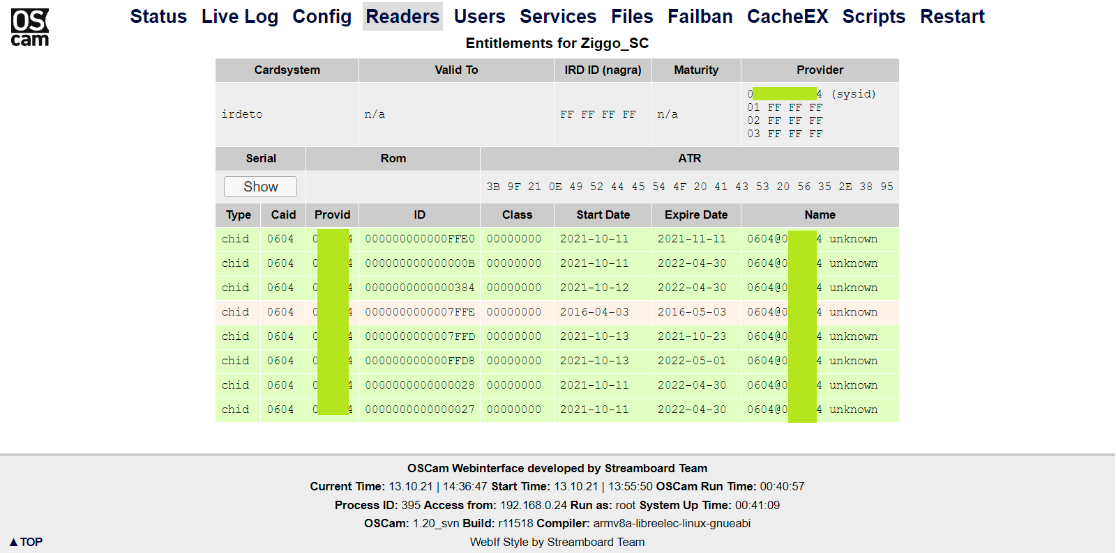

Zilverster Geplaatst: 13 oktober 2021 Geplaatst: 13 oktober 2021 3 minuten geleden, Zilverster zei: @homeaion, Ik zie dat bij jou de dvbapi off line is .... Je kunt die log gegevens eens vergelijken met jou log uit je eigen gegevens. Op dat andere topic zie je zelfs de ATR. Link : https://www.sat4all.com/forums/topic/330423-tvheadend-oscam-smartreader-no-decoding/ Gr. Zilverster. You are "The last in line" - Ronnie James Dio R.I.P.
homeaion Geplaatst: 14 oktober 2021 Auteur Geplaatst: 14 oktober 2021 14 hours ago, Zilverster said: 2021/10/14 15:01:45 5C0B5ED9 r (reader) Ziggo_SC [smartreader] Reader initialized (device=TripleP2;Serial:00000022, detect=cd, mhz=600, cardmhz=600) 2021/10/14 15:01:46 5C0B5ED9 r (reader) Ziggo_SC [smartreader] card detected 2021/10/14 15:01:53 5C0B5ED9 r (reader) Ziggo_SC [smartreader] ATR: 3B 9F 21 0E 49 52 44 45 54 4F 20 41 43 53 20 56 35 2E 38 95 2021/10/14 15:01:53 5C0B5ED9 r (reader) Ziggo_SC [smartreader] Effective reader settings mhz =600 F= 558 D= 1 N=0 T=14 inv=0 parity=NONE 2021/10/14 15:01:55 5C0B5ED9 r (reader) Ziggo_SC [smartreader] detect irdeto card 2021/10/14 15:01:55 5C0B5ED9 r (reader) Ziggo_SC [smartreader] Irdeto SC 58 version 21 revision 1, patch level e 2021/10/14 15:01:55 5C0B5ED9 r (reader) Ziggo_SC [smartreader] caid: 0604, acs: 0.05, country code: NLD 2021/10/14 15:01:55 5C0B5ED9 r (reader) Ziggo_SC [smartreader] providers: 4, ascii serial: ##########, hex serial: ######, hex base: ## 2021/10/14 15:02:00 5C0B5ED9 r (reader) Ziggo_SC [smartreader] Warning: needed try nr 2, next ECM has some delay 2021/10/14 15:02:04 5C0B5ED9 r (reader) Ziggo_SC [smartreader] active providers: 4 (abcdef,ffffff,ffffff,ffffff) 2021/10/14 15:02:04 5C0B5ED9 r (reader) Ziggo_SC [smartreader] found card system irdeto 2021/10/14 15:02:04 5C0B5ED9 r (reader) Ziggo_SC [irdeto] THIS WAS A SUCCESSFUL START ATTEMPT No 1 out of max allotted of 1 2021/10/14 15:02:05 5C0B5ED9 r (reader) Ziggo_SC [irdeto] entitlements for provider: 1, id: ABCDEF 2021/10/14 15:02:05 5C0B5ED9 r (reader) Ziggo_SC [irdeto] chid: FFE0, date: 2021/10/11 - 2021/11/11 2021/10/14 15:02:05 5C0B5ED9 r (reader) Ziggo_SC [irdeto] chid: 000B, date: 2021/10/11 - 2022/04/30 2021/10/14 15:02:05 5C0B5ED9 r (reader) Ziggo_SC [irdeto] chid: 0384, date: 2021/10/12 - 2022/04/30 2021/10/14 15:02:05 5C0B5ED9 r (reader) Ziggo_SC [irdeto] chid: 7FFE, date: 2016/04/03 - 2016/05/03 2021/10/14 15:02:05 5C0B5ED9 r (reader) Ziggo_SC [irdeto] chid: 7FFD, date: 2021/10/13 - 2021/10/23 2021/10/14 15:02:05 5C0B5ED9 r (reader) Ziggo_SC [irdeto] chid: FFD8, date: 2021/10/13 - 2022/05/01 2021/10/14 15:02:05 5C0B5ED9 r (reader) Ziggo_SC [irdeto] chid: 0028, date: 2021/10/11 - 2022/04/30 2021/10/14 15:02:05 5C0B5ED9 r (reader) Ziggo_SC [irdeto] chid: 0027, date: 2021/10/11 - 2022/04/30 ATR staat er netjes en doet niet vreemd. Echt ik heb alles tig keer clean ge installeerd. Gebeurt niets. DVBAPI is connected en vangt alleen EMM's maar decodeerd niets.

homeaion Geplaatst: 16 oktober 2021 Auteur Geplaatst: 16 oktober 2021 Ik heb het probleem kunnen achterhalen. Het was een hardware probleem. Nadat ik de Triple reader verving voor een blauwe Smargo (die ik maar voor de zekerheid had gekocht) was het probleem weg. Niets aan de settings veranderd. Alleen nieuwe reader toegevoegd en de Triple uitgezet. BAM! Hij doet het. Triple readers zijn waardeloos.
