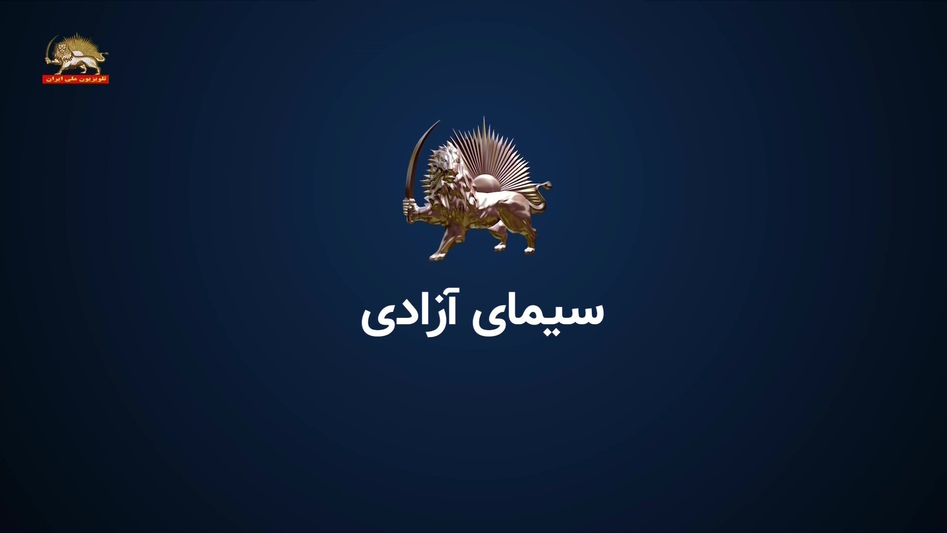

"ByoBlu" is gestopt op 10.930 h 30.000 fec 2/3 8PSK
TurkmenÄlem MonacoSat - 52° Oost:
"Sima HD" is gestopt op 10.887 v 27.500 fec 2/3

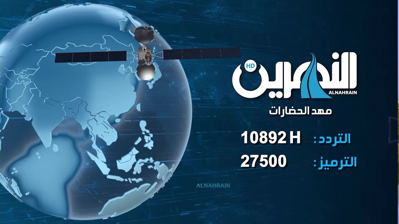

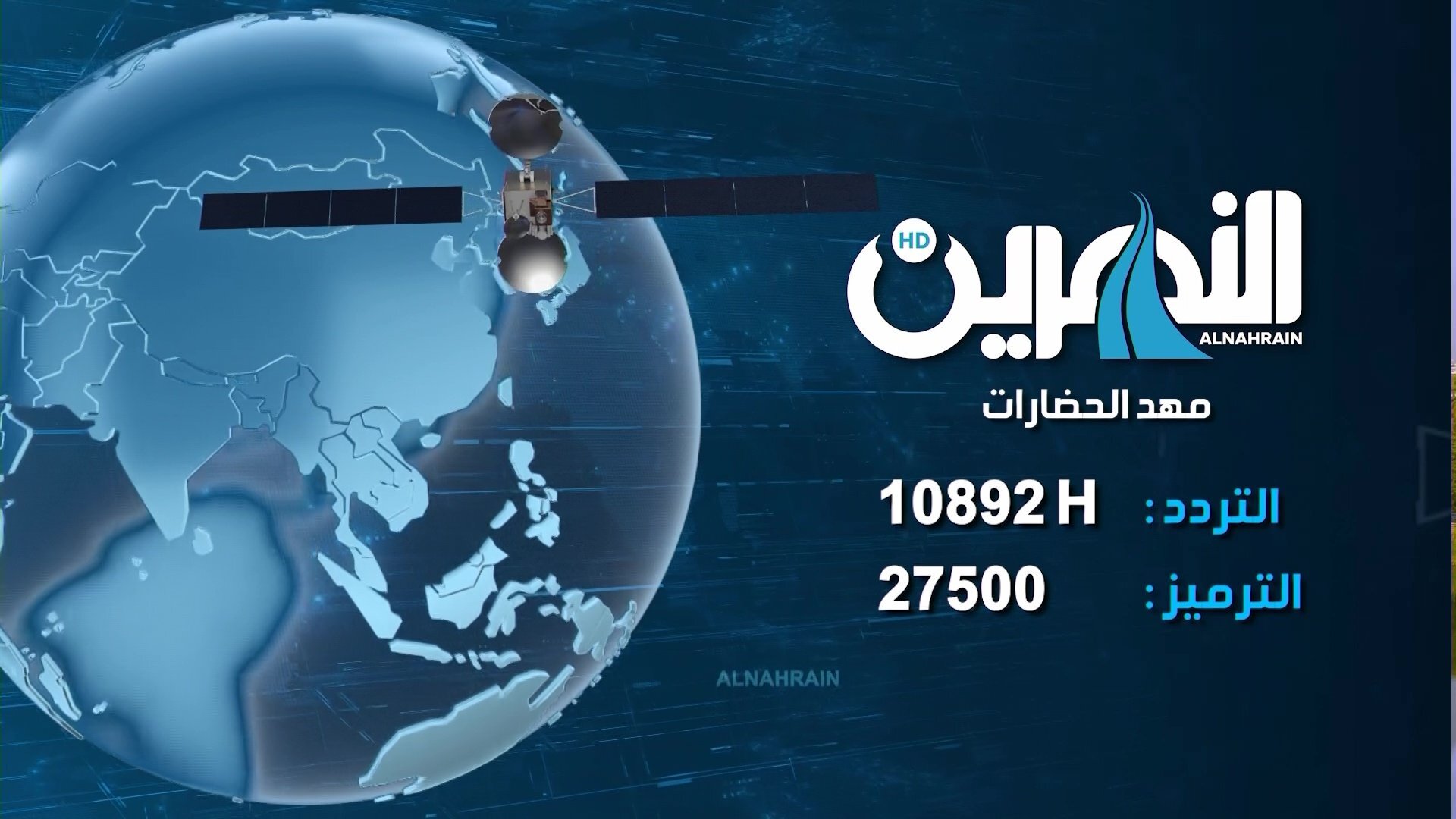

21,6°E 11692 H 1600 Aut  ID: Program 1 (Alnahrain)

TurkmenÄlem MonacoSat - 52°E:
10887 V 27500 2/3  ID: Sima HD   terug
