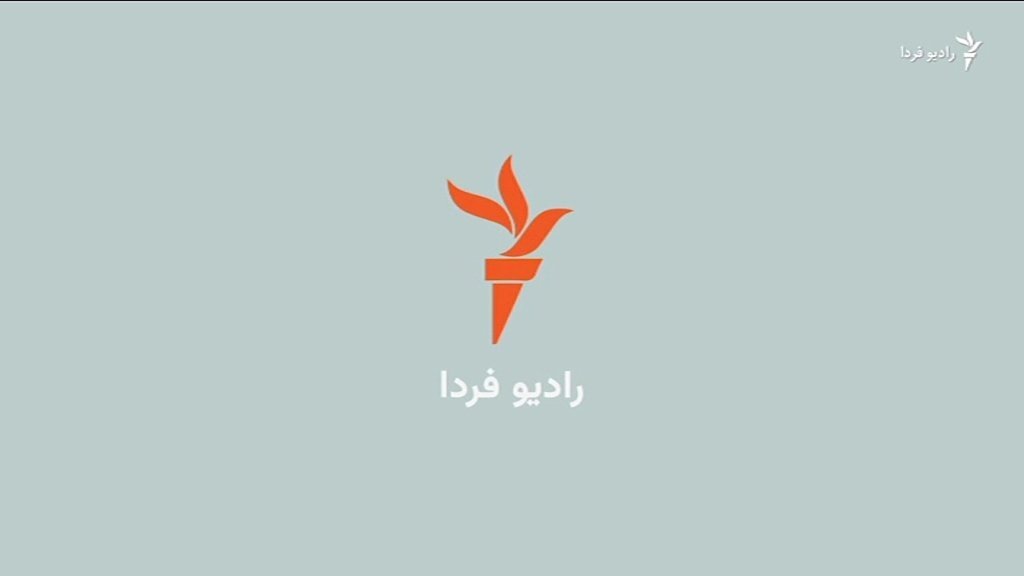

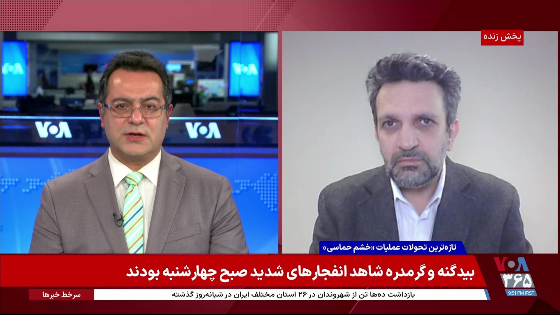

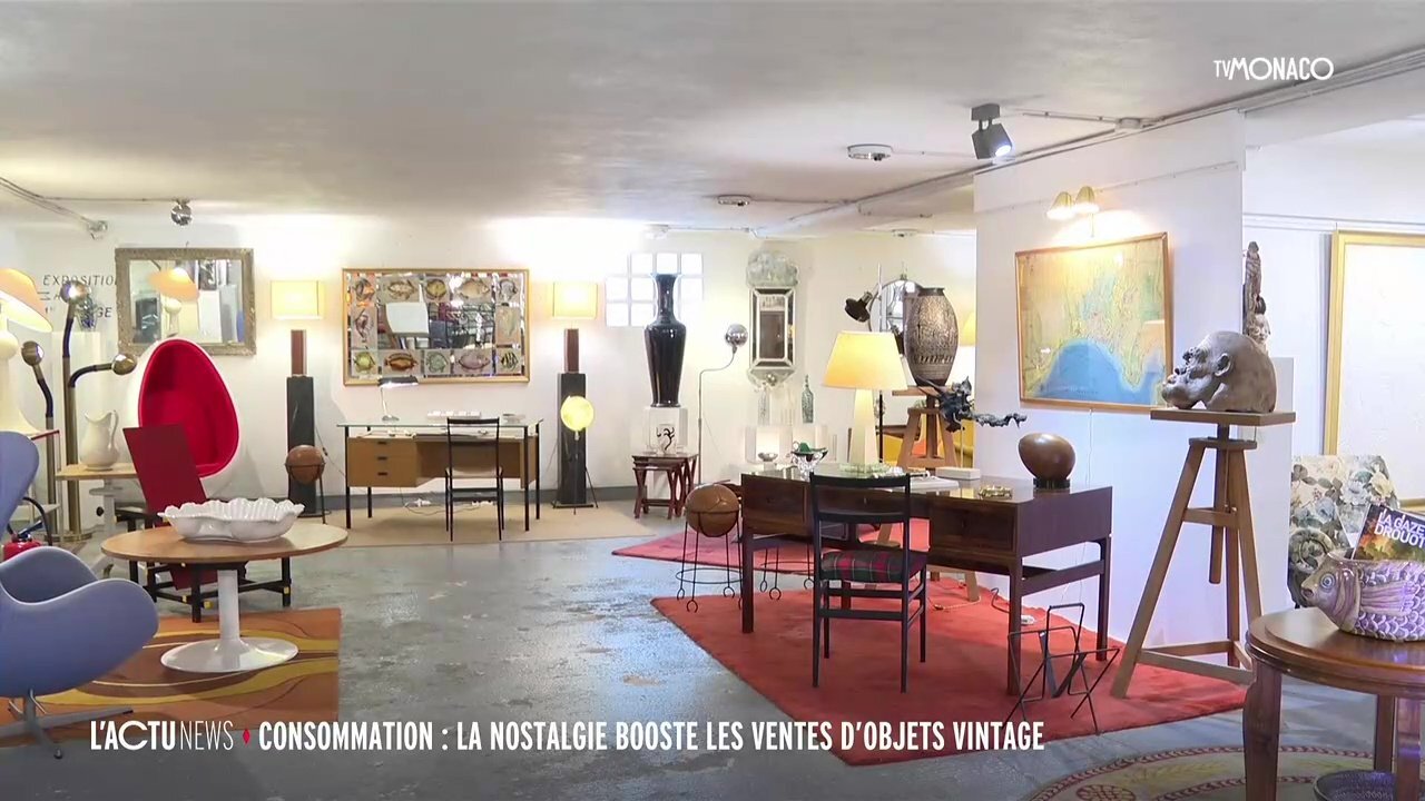

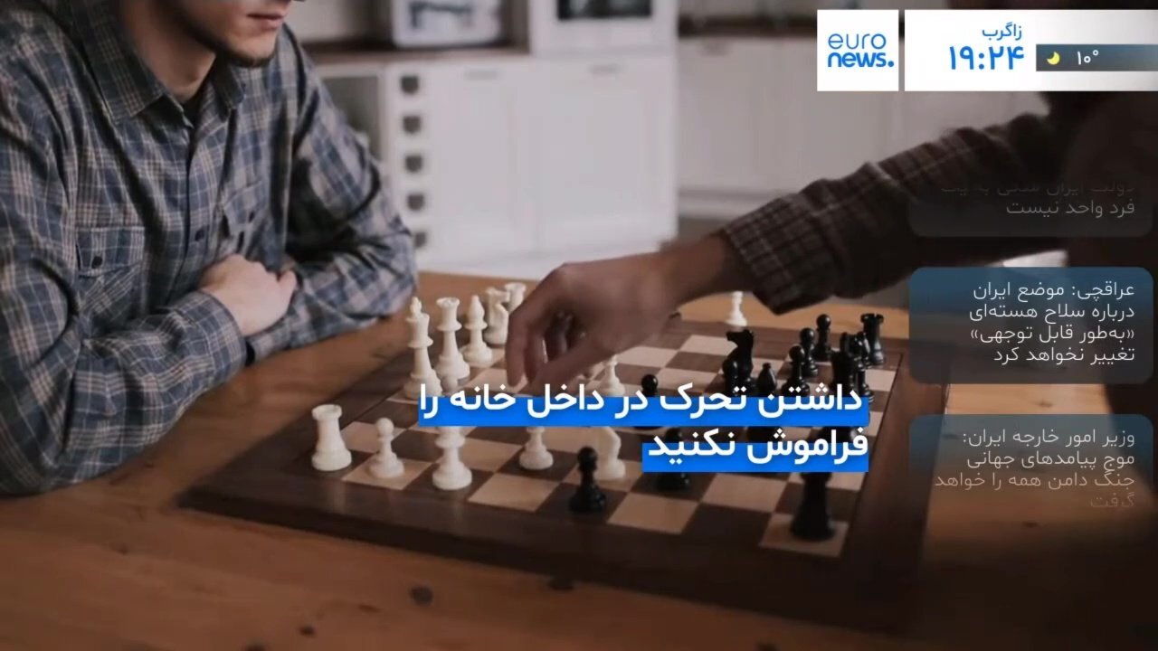

TurkmenÄlem MonacoSat - 52°Oost:
11382 H 27500 2/3  ID's: Superyacht TV en Mellig TV
11420 H 27500 2/3  ID's: VOA Persian, Superyacht TV, Euronews, Tv Monaco, CNews en No Name

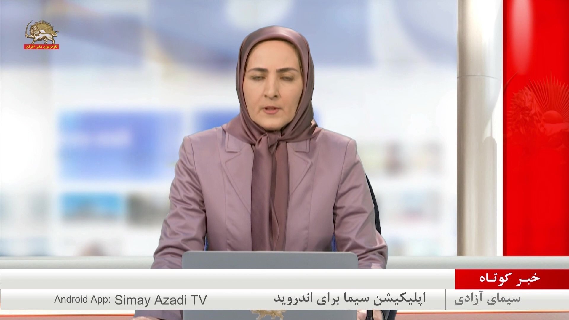

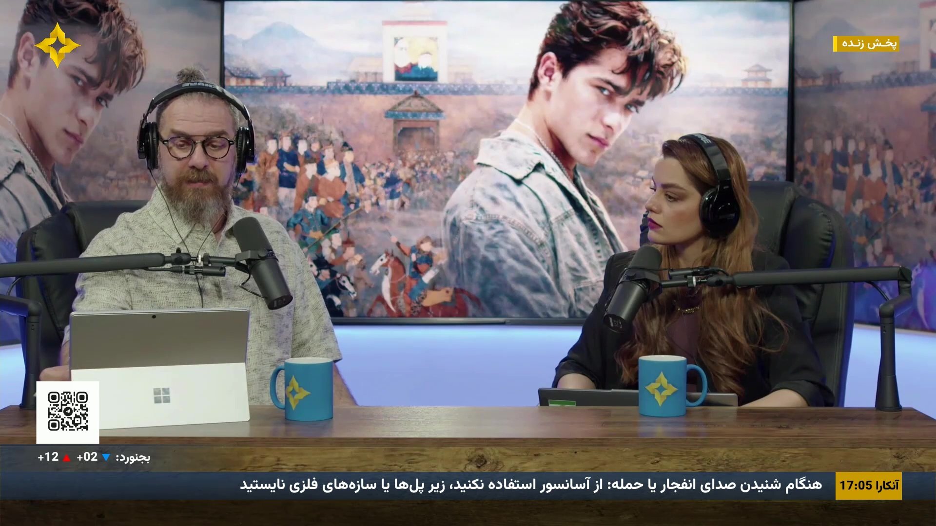

Nog enkele zenders erbij op deze frequentie
11420 H 27500 2/3  ID's: STAR TV, Azadi SD, Azadi HD en BBC News Persian

Name: "TV Monaco" Provider: "US Media CAST"
11421, H, 27500
52.0°E (0520 - TurkmenÄlem MonacoSat)
4:2:0 1280x720 50fps 1577kbps 16:9
NetwordID: 5478 TransponderID: 5478 ServiceID: 54
Video: 5401(H.264) Audio: 5402 - (AAC-ADTS)
PCR: 5401 PMT: 5400 Teletext: 0

"Euro News" nieuw op 11.421 h 27.500 fec 2/3.
parallel naast de uitzending op 11.420 v 27.500 fec 3/4
Name: "Euro News" Provider: "US Media CAST"
11421, H, 27500
4:2:0 1280x720 50fps 1675kbps 16:9
NetwordID: 5478 TransponderID: 5478 ServiceID: 53
Video: 5301(H.264) Audio: 5302 - (AAC-ADTS)
PCR: 5301 PMT: 5300 Teletext: 0

"Simaye Azadi SD" is gestopt via de 11.221 v 27.500 fec 2/3
men is nieuw te ontvangen via de 11.421 h 27.500 fec 2/3
Name: "Azadi TV SD" Provider: "US Media CAST"
11421, H, 27500
4:2:0 720x576 25fps 2057kbps 16:9
NetwordID: 5478 TransponderID: 5478 ServiceID: 59
Video: 5901 Audio: 5902 -
PCR: 5901 PMT: 5900 Teletext: 0
