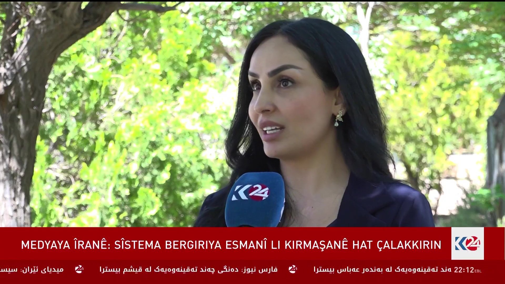

"Kurdistan 24" nieuw via de 12.520 v 27.500 fec 2/3 8PSK.
parallel naast de uitzending via de 11.373 h 27.500 fec 3/4 8PSK
Name: "Kurdistan 24" Provider: "IKOMG"
12520, V, 27500 8PSK FEC 2/3
13.0°E (0130 - Eutelsat Hot Bird 13F/G)
4:2:0 1920x1080 25fps 5736kbps 16:9
NetwordID: 318 TransponderID: 9000 ServiceID: 9021
Video: 1211(H.264) Audio: 1212 - kur
PCR: 1211 PMT: 921 Teletext: 0

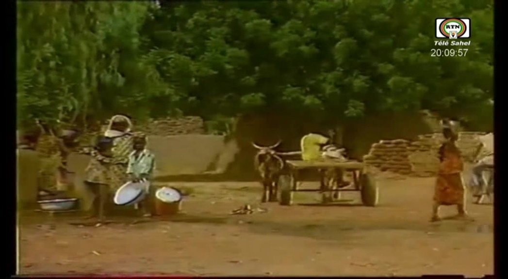

11900, H, 27500 8PSK FEC 2/3
9.0°E (0090 - Eutelsat 9B)
4:2:0 720x576 25fps 1474kbps 16:9
NetwordID: 158 TransponderID: 5900 ServiceID: 30
Video: 301(H.264) Audio: 302 -
PCR: 301 PMT: 300 Teletext: 0
