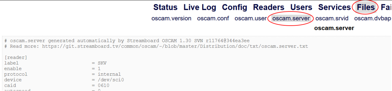

[reader]
label = SKV
enable = 1
protocol = internal
device = /dev/sci0
caid = 0610
boxkey = 1122................
rsakey = 3C8...............
force_irdeto = 1
detect = cd
mhz = 500
cardmhz = 600
ident = 0610:03F2D8,FFFFFF,FFFFFF,FFFFFF,000000
chid = 0610:00000D
group = 1
emmcache = 1,3,2,0
auprovid = 03F2D8
aangepast door Greatone

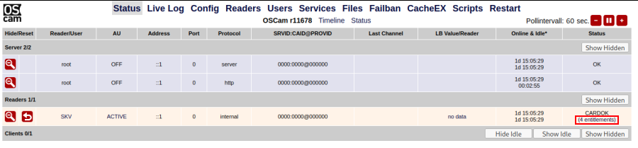

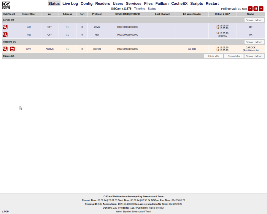

4 minuten geleden, robbedoeske zei:
Beetje oude topic, maar is dit nog steeds actueel?
Gewoon proberen
